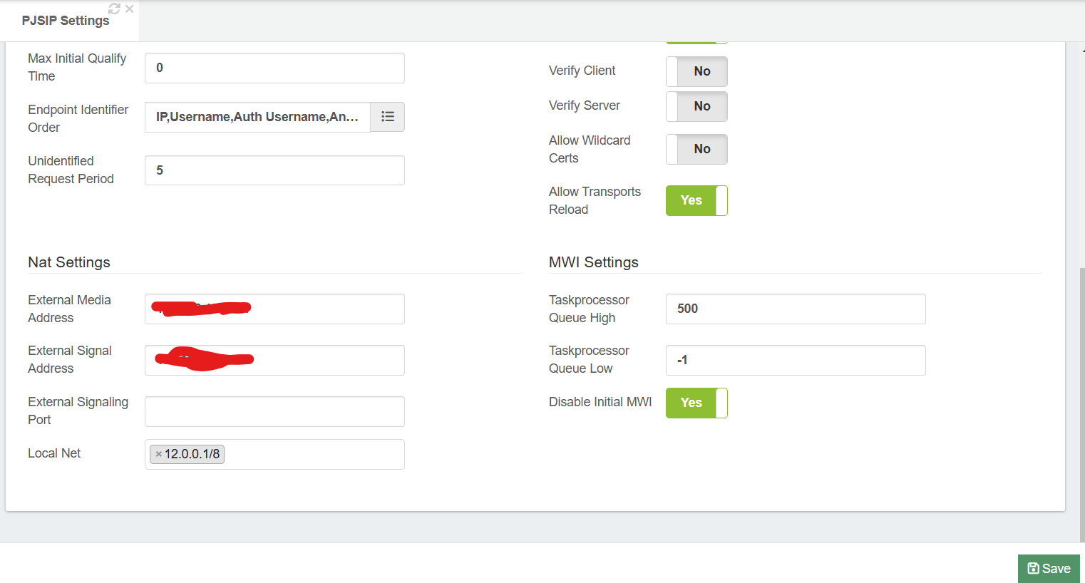

Set up the Public and Private IP of your server in the PJSIP Settings module.
VitalPBX is on VPS on Vultr. I don’t believe it has Private IP. So this is what I configured :
I have tried with or without 127.0.0.1/8 in the Private address but still it’s one-way audio.
On the side note, I have no issue with Deskphone. Only with VitXi WebRTC

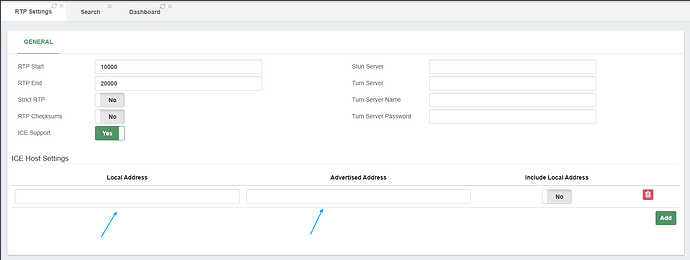

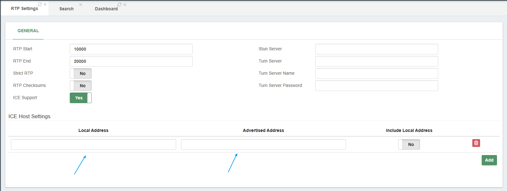

In addition, configure the local and public address in the RTP Settings module:
Can you clarify what is my Local Address? I looked everywhere on Vultr VPS but can’t seem to find Private IP of the server.
Could you please check if there is an option labeled “Enable Private Network” enabled in the Network settings?

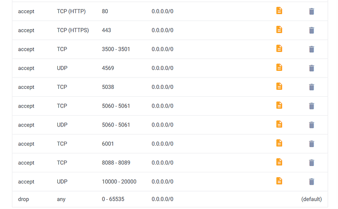

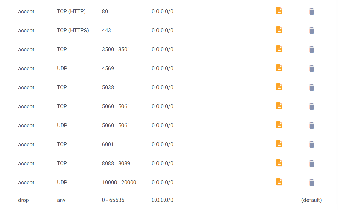

Additionally, if you do not have a private IP, the issue may be that the RTP ports are not enabled in your Vultr instance’s firewall. Could you confirm whether the port range from 10000 to 20000 is open?
I couldn’t find Enable Private Network on Vultr but I managed to enable Vultr Firewall.
As soon as I enabled the firewall, everything stopped working (understandably), So I had to open these ports :

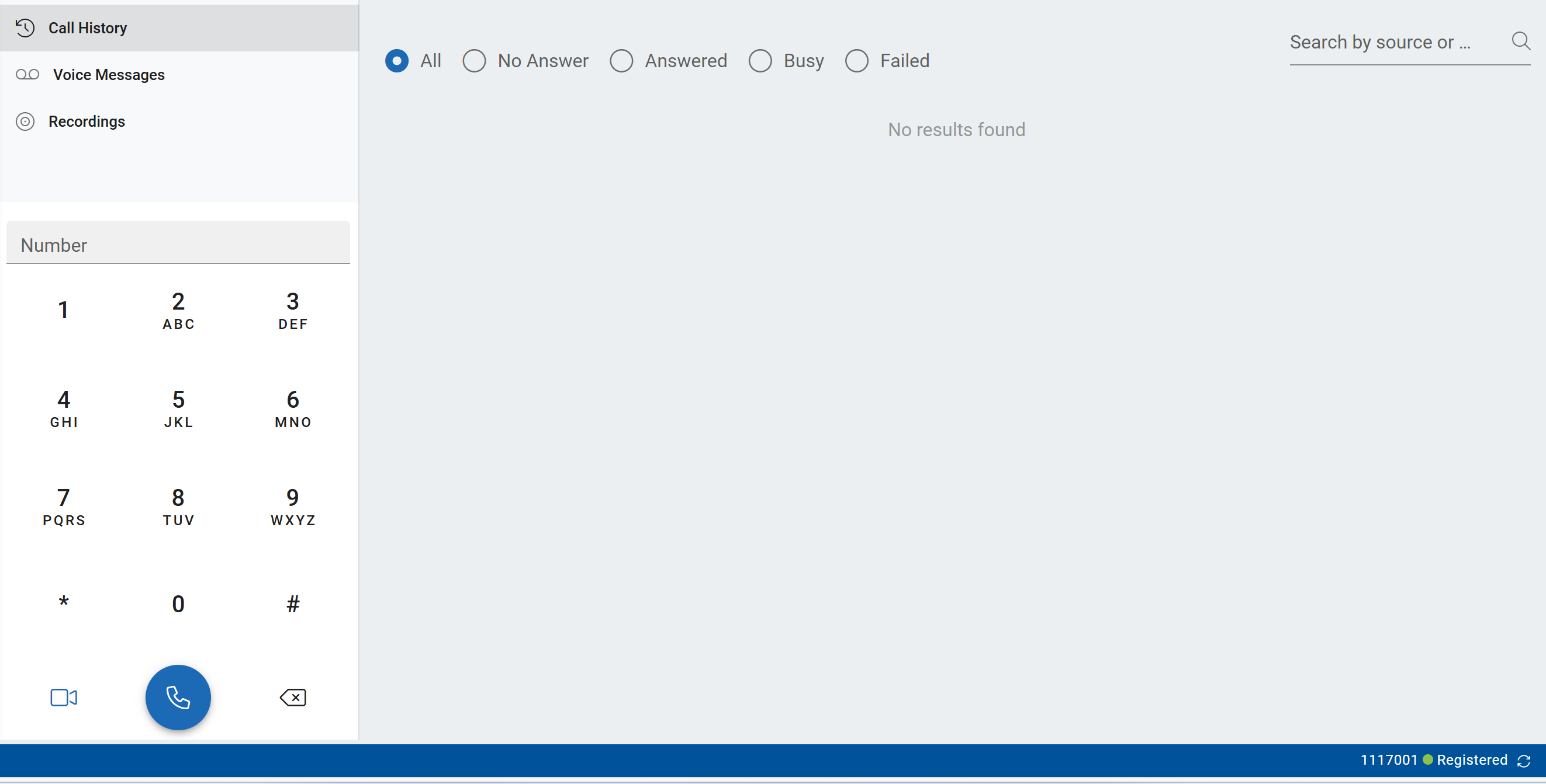

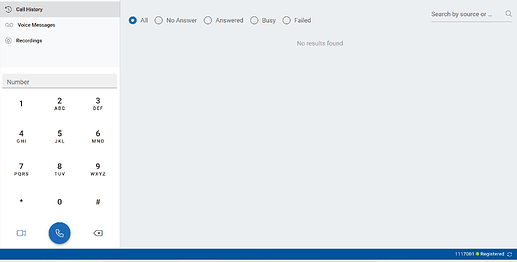

Everything appears to work except VitXi, now extension is not registering at all :frowning:
Do you get any error messages in VitXi or does the extension just appear as unregistered?
No error, it’s just shows red dot and says unregistered

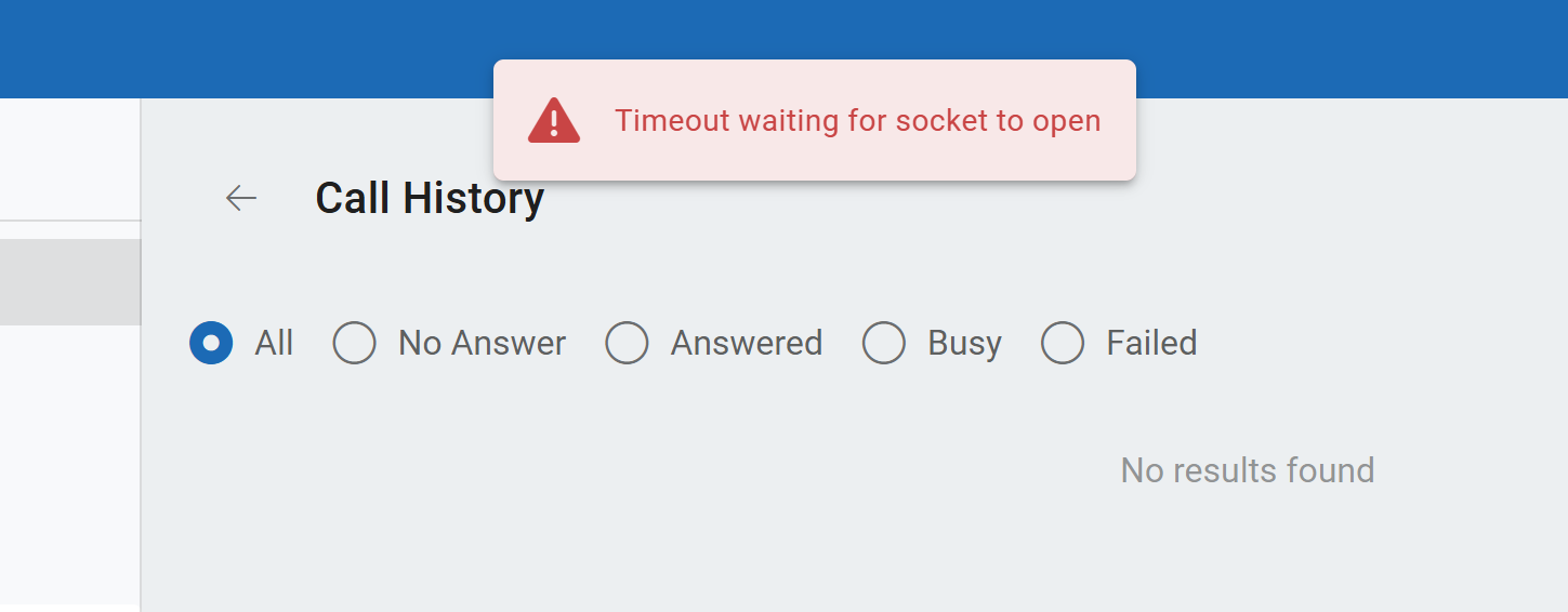

Facing a similar kind of issue. The extension is showing registered but getting error “Timeout waiting for socket to open”.
It’s an old installation and was working fine. Nothing changed.
Extension is showing registered, I can make calls but keep getting this error. Plus, it stopped showing the Call history.

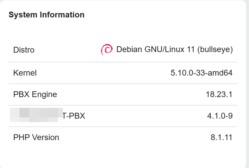

System info -
Please verify that port 6001 is enabled in VitalPBX and in any firewall you have active
