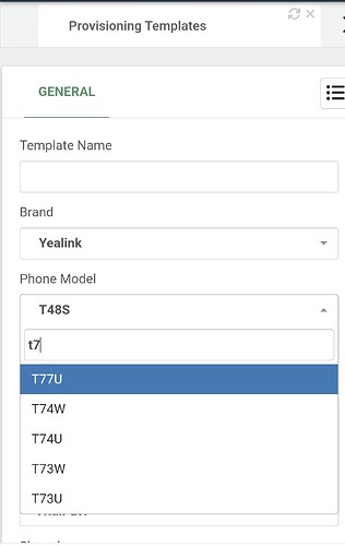

I can see the T7X and also T77U just fine.

Did you try to create a new template?
Can’t create a template for it since it’s not in the list.
Have you restarted your PBX since the update? We sometimes find new features dont appear until a reboot.
Ended up having to run dpkg --configure -aon both tenants. After that I was able to see the the T7 models.
