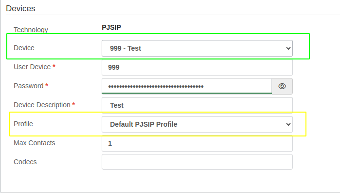

You can create multiple devices per extension, so create a second device to your default one.
Click on Device (Green Box) and select new to create a new device for your extension.
Once you have created a new device just select the appropiate profile for it, in this case WebRTC

Also if you want to have multiple SIP registers with the same extension you need to increase the MAX Contacts from 1 to 2-5.
In our system being tested for VitXi, we have an extension down as default WebRTC profile, but also a work deskphone. I am not sure what this will cause in terms of issues, but the deskphone, Vital Connect and VitXi all ring, our “Max Contacts” is at 5.
