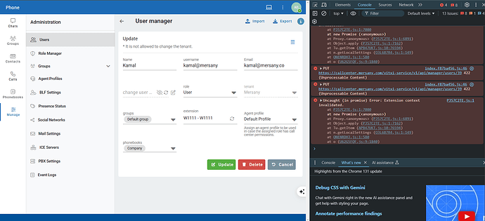

I Have an error while choosing Hot Disking Device inside VITXI even Wthe ebRTC Client option is ON (YES) can you solve it?

Hi!
Could you please share a screenshot of the issue,
here is the error

the only way to create a single extension with 2 devices is the Hotdesking Feature , that’s why I created one extension with no device then created 2 devices PJSIP for TLS and WebRTC for VITXI ,
here is the problem the VITXI send me an error when I choose a hotdesking device even I enable WebRTC client option is ON
the device already in list but when I select it and update I got an error in console
here is the error
No, you can create a regular extension with two devices.
