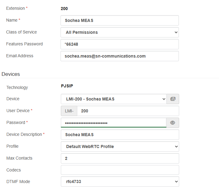

The device for extension is set to use a WebRTC Profile, which is wrong as communicator is not a WebRTC client, add a a new device with the default PJSIP profile or modify you current one if you are not using WebRTC and it should register properly.

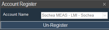

hi Hlev,
Thank you for your help. We did try with PJSIP Profile as well and it didn’t work neither. Just to be sure, VitalPBX Communicator is registered but incoming call doesn’t ring it. Only the deskphone. Please note the screenshot below is with PJSIP profile selected.
Keep the device profile as PJSIP, log into your server console launch sngrep and get some logs of your calls to see what is happening.

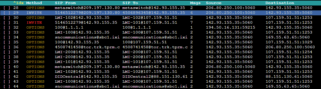

We’ve trace the inbound calls through sngrep and here is what we see
  1. The first INVITE is the carrier (209.197.130.80) forwarding the call to the VitalPBX (142.93.155.35)
  2. The second INVITE is the PBX forwarding to the endpoint. If you notice, the destination endpoint is port 1253 which correspond to the Deskphone as in the updated screenshot below.
In sngrep, we never see any invite sent to port 1254…

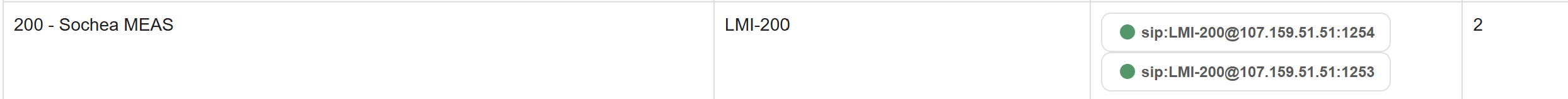

Also, if you look at the screenshot, you do see the 2 endpoints on line 37 and 38 using respectively port 1254 and 1253.
Are we missing a configuration somewhere?
