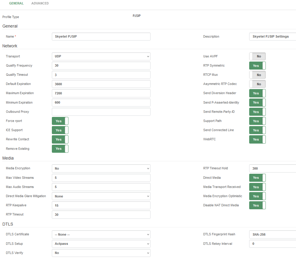

Couple of things:
In the Trunk:
  • For the Remote Host use, out.skyetel.com since it uses SRV.
  • Permanent Auth Rejection, set to No.
  • From domain, can be removed, but shouldn’t really make a big difference.
In the Skyetel PJSIP profile:
  • Set WebRTC to no
  • Set Support Path to no
There are more RTP settings that can be tweaked if you have audio issues, but first lets get SIP working.
