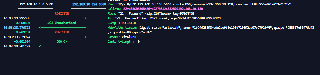

Thanks for the reply,
While registering, sngrep gives me an Unauthorized but the phone registers.
Outgoing calls also gives me an Unauthorized and are working.

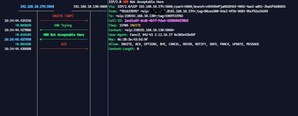

Incoming call doesn’t ring the phone and I get a 488 - Not Acceptable Here.
I don’t know what to make of this, at first I thought it was a codec problem but my phone isn’t even ringing.
Your issue does look like a codec issue.488 errors tells you their is no media compatibility between the calling and receiving endpoint, so you wont get a ring at all.
Check the codec setup on both server and the phones.
