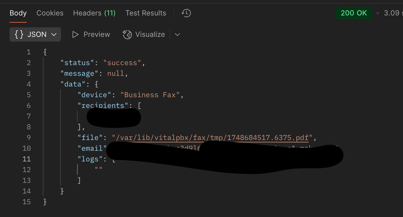

My virtual fax api has been working until a few days ago.
I am able to get a successful 200 OK reply but it is not showing up on the fax viewer and the fax is not sending either. I have tested it with Postman as well.
Actually I worked it out and I just needed to change the url address to get it to download properly.
The 200 OK response unfortunately was not very informative and I thought VitalPBX could download the file when in actually fact it couldn’t so no fax was generated to send.
