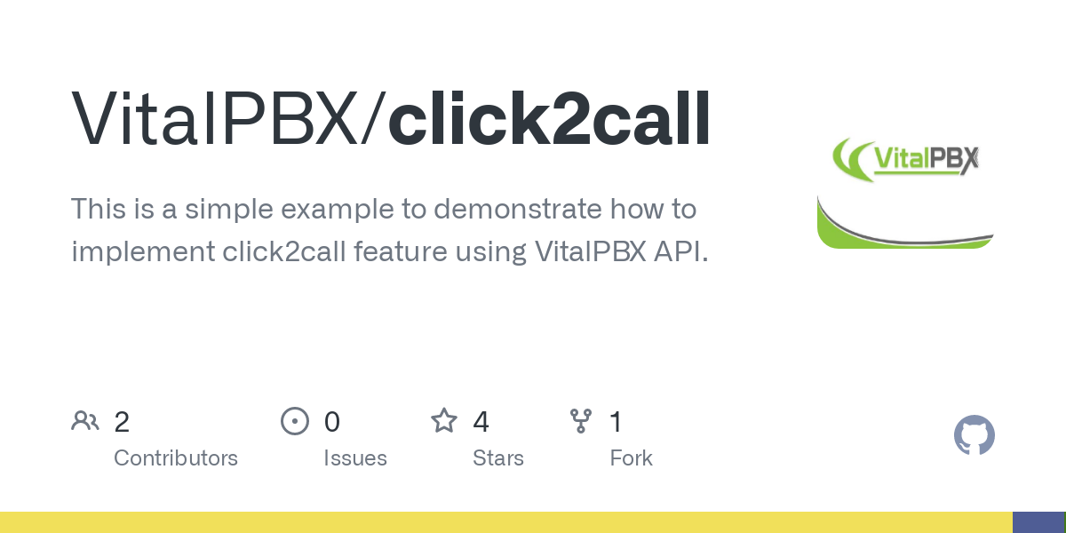

The reason i want to use fop2 is for click2call or click 2 dial…
ive seen this post but not able to make how am i going to deploy or use it…
You can have the same functionality in Sonata Switchboard and through the VitalPBX API.
In Call file they said as following
Here, you must define your API Key (Generated on VitalPBX), the extension number from where the calls will be performed, and the list of numbers to be called.
do i need to add all the available extensions in vitalpbx ?

No. This is something you can configure in your CRM to utilize the VitalPBX Click to Call API.
