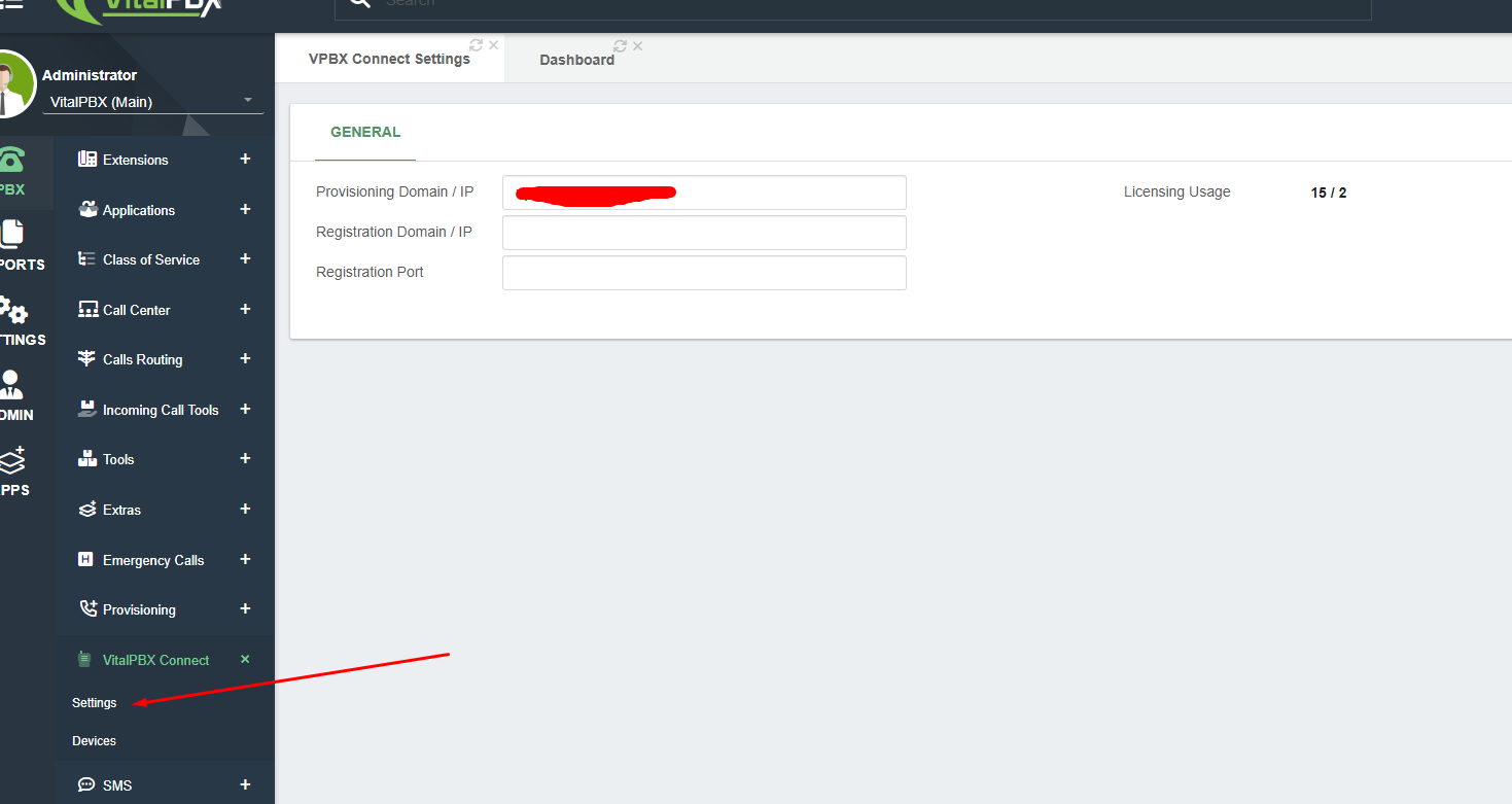

Did you set up the Connect Settings with your server’s public IP? After configuring this, you must re-create the Connect devices.
I have my public IP in the both Provisioning and Registration and port is blank.
It gets the information to deplay my name, but my name just keeps on flashing white.
