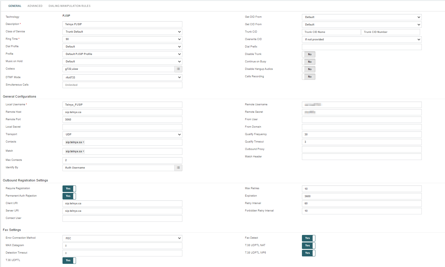

Below is a screenshot of my configuration:
I have tried with Authentication (current settings) and IP based without luck.

But while playing around I changed these settings and it now works:
Changed sip.telnyx.ca to a SIP URI format sip:sip.telnyx.ca
I am now able to fax and make calls successfully with VitalPBX. Cheers
