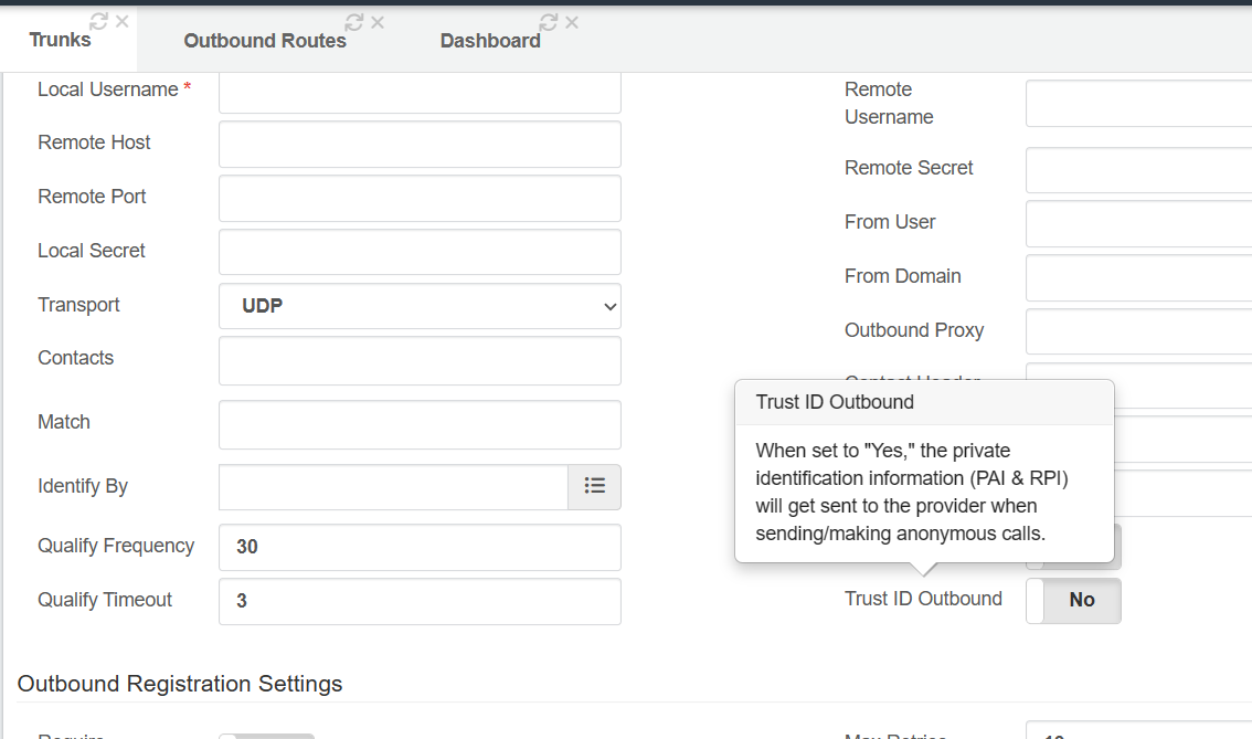

One can enable this option under Trunk by enabling trust ID outbound. Plus, you may have to assign DID to users ( One DID can be shared with same Tenant or each unique for each user ).
I hope this will help you… cheers!!!
Thank you for your response. I was hoping to implement the following:
  1. Leave appropriate CID associated with the Extension.
  2. Create an Outbound Route that used a Prefix to designate the call as Private. This Route would use a Trunk whose PAI would be set.
  3. The new PAI enabled Trunk would be a duplicate of an existing trunk used with the VoIP provider.
  4. The PAI enabled Trunk would not change the CID derived from the Extension.
Would this work.
