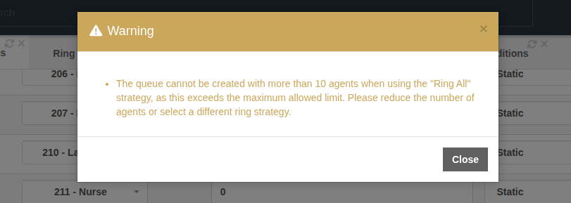

Why is there now a limit to the number of extensions when the ring strategy is set to ring all on Vital 4.5 systems? I have several clients still on 4.2.X which have ringall set for their single queue with more than 10 members without issues. If this is due to performance issues, it should be a warning indeed but shouldn’t be a hard limit. What is going to happens when its their time to be upgrade to 4.5?
Currently setting up a queue with 12 members and I cant due to the hard set limit. This is a single server for a client, 2 extra extensions in the queue is not really going to cause performance issues for them, but them not getting all the extensions they need would certainly be an issue. A ring group is not an option for them as they will be using Stats and queues are needed for that and they are searching for stats per queue.
This is a limit you can disable or change in the System General module under the main tenant!
Perfect, thanks @miguel
