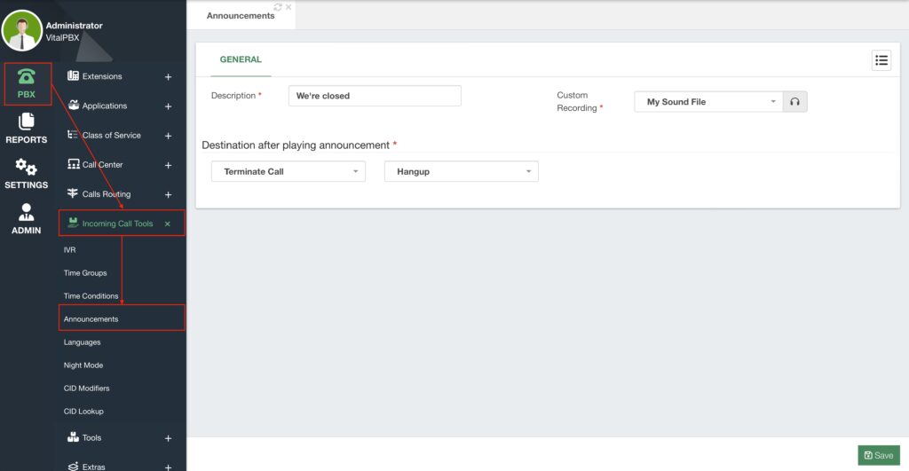

You must make announcment from your Recording >
For a callfow:
CFN (Not reachable) To Queue (without Agent) , with greeting Message —> hangup
Mariam, that is excellent, just tried it and it works perfectly, thank you.
