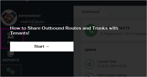

You can define the trunks and outbound routes on the main tenant and then share them with your tenants.
OK so I had this working like shown in those steps (that iroad tutorial is great!) however it seemed like I had to go to each tenant as well and add the allowed outbound route. I realize this is a one time setup per tenant deal but is there a way that if the tenant has no outbound route specified it fails over to using the routes allowed to them from the main tenant?
