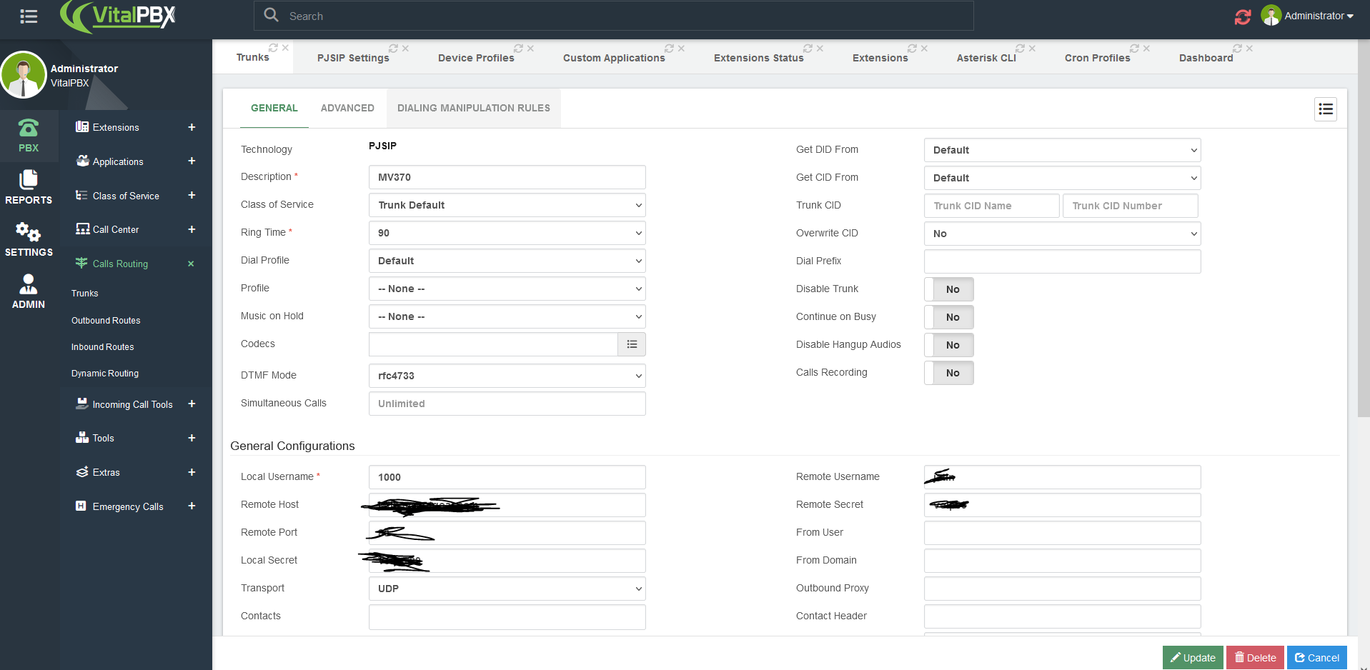

Need help setup PJ SIP trunk with Portech MV370
Hi I am struggling to setup pjsip trunk with Portech MV370, I have setup VITALPBX on raspberry pi with ip 192.168.1.15 where as my MV370 GSM To VOIP gateway setup on 192.168.1.8. What settings I need and to put on VITALPBX and MV370. I have attached the screenshots of MV370 Setting page and trunk
I will be really thankful if someone help me to setup trunk for outbound and inbound call

I see the red circle on top, did you apply changes?
Did you enable the registration option in your trunk?
On the other hand, the Local Secret isn’t required from my point of view!.
Hi Miguel , thanks for the reply, I applied the changes but not able to place outbound call or receive inbound
Yes I did
is my other settings correct ?
