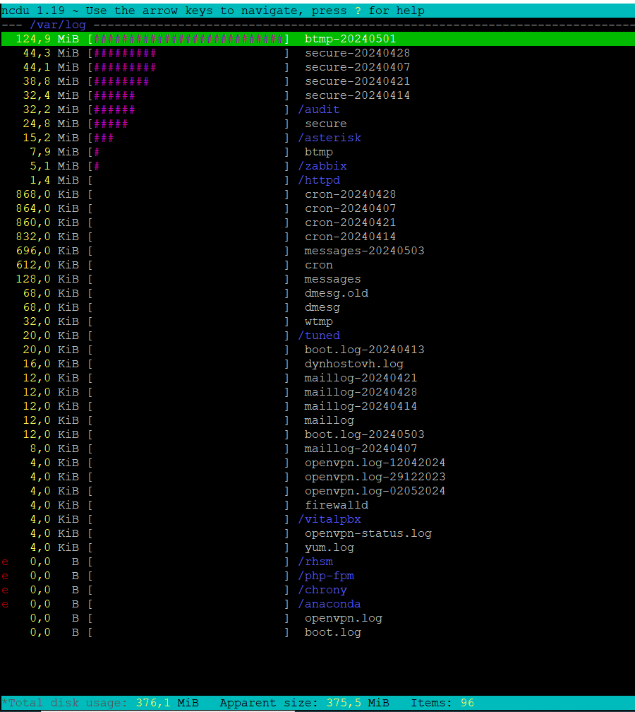

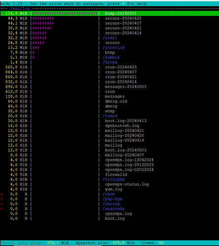

Install ncdu
You will see what uses the most space.
You can delete with it, too.
Thank you for the answer . I’ll try, but how do I recognize an important file from another that can be deleted?
Just share a screenshot of the largest files (ncdu).
Somebody might be able to help here.

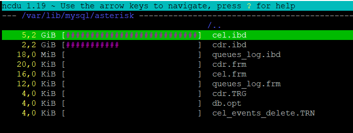

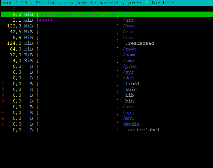

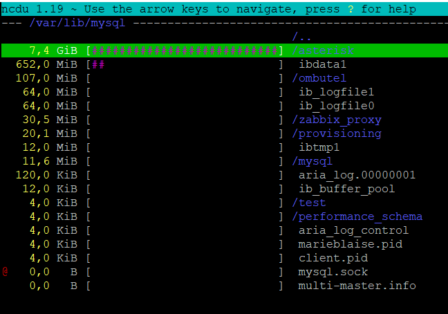

16GB is not much. You can always run into space problems again.
Can you live without CEL Events being logged? You can turn them off.
Don’t know if it gets emptied after turn off.
These 2 files do not make this size in one day. I think we should be able to reduce their size with a command to purge them of the oldest messages
Yes there is a maintainance addon for vitalpbx. CDR should get smaller.
I don’t know about CEL Events. Let us know!
