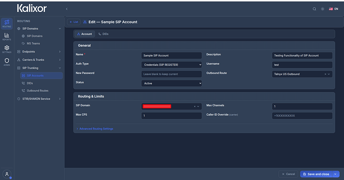

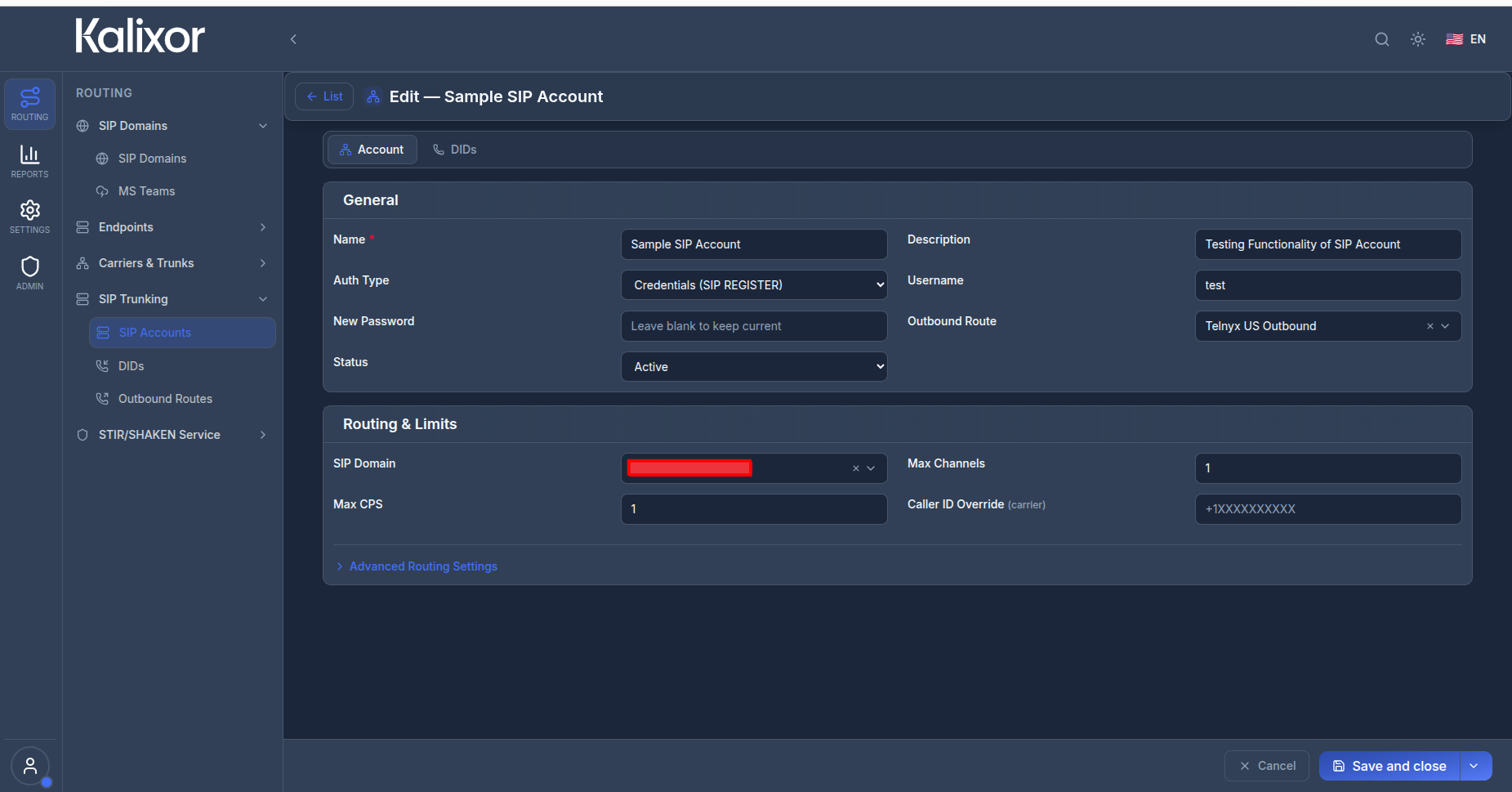

While I have you, can you explain the functionality of SIP Accounts under Routing>SIP Trunking>SIP Accounts

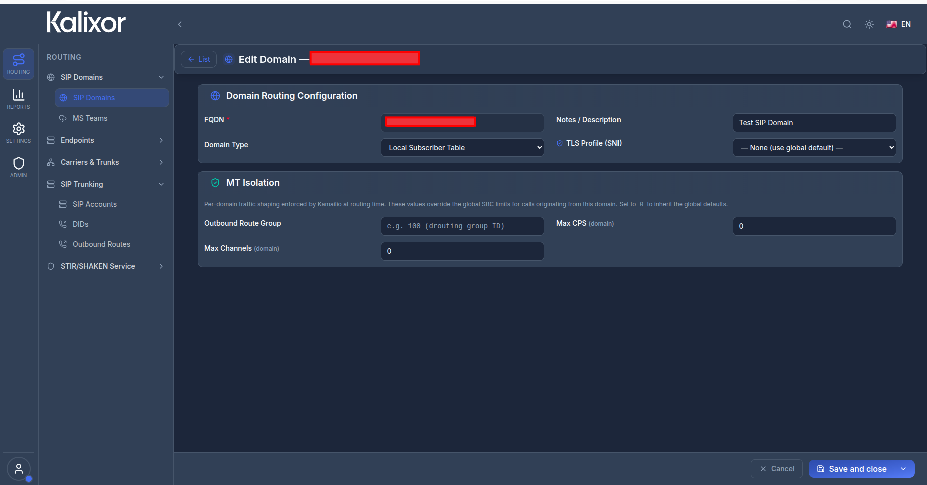

I have a dobain created and set to Local Subscriber Table as shown
I also have a SIP Account created and assigned to that domain;
When I try to register, I get a 403 Not Relaying.
I am trying to register directly to the SBC and test inbound and outbound calls to test two-way audio with the “patched” RTPEngine
