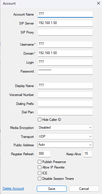

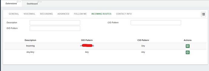

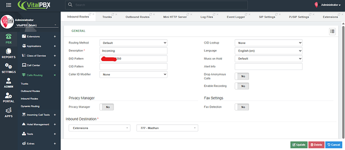

Hi team, I am facing a issue with incoming calls are not landing to the extension
i configured the extension in the softphone but the incoming are not landing on the extension.

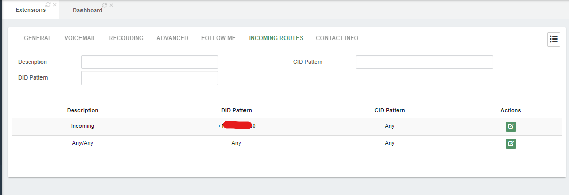

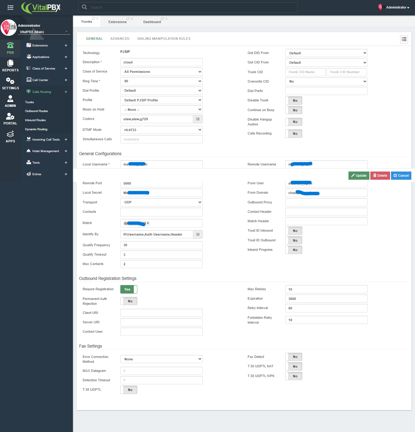

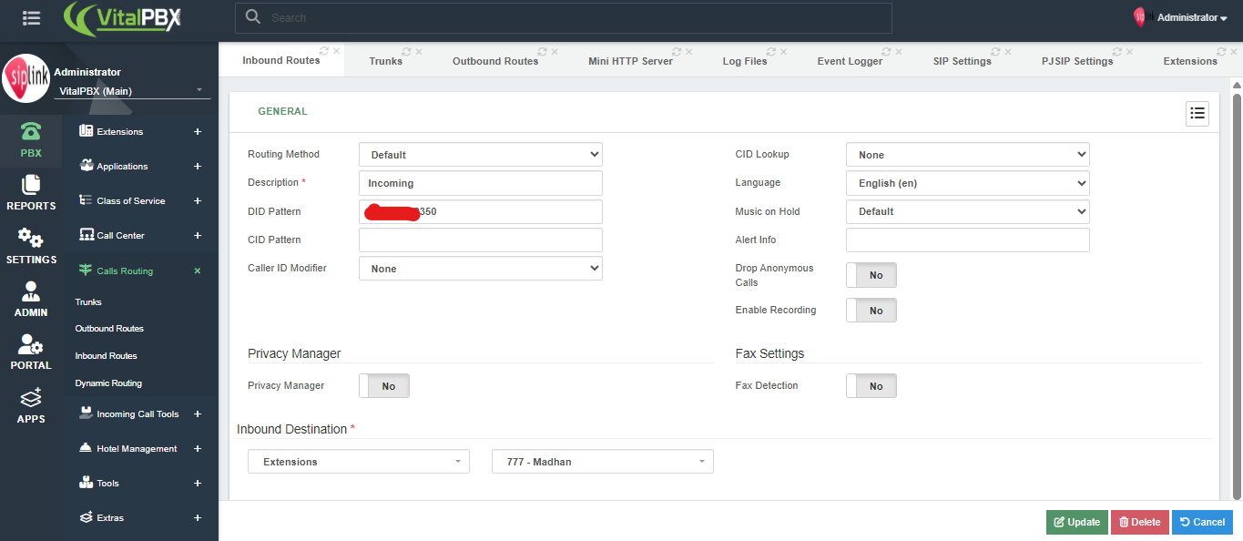

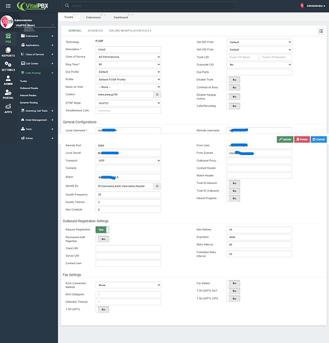

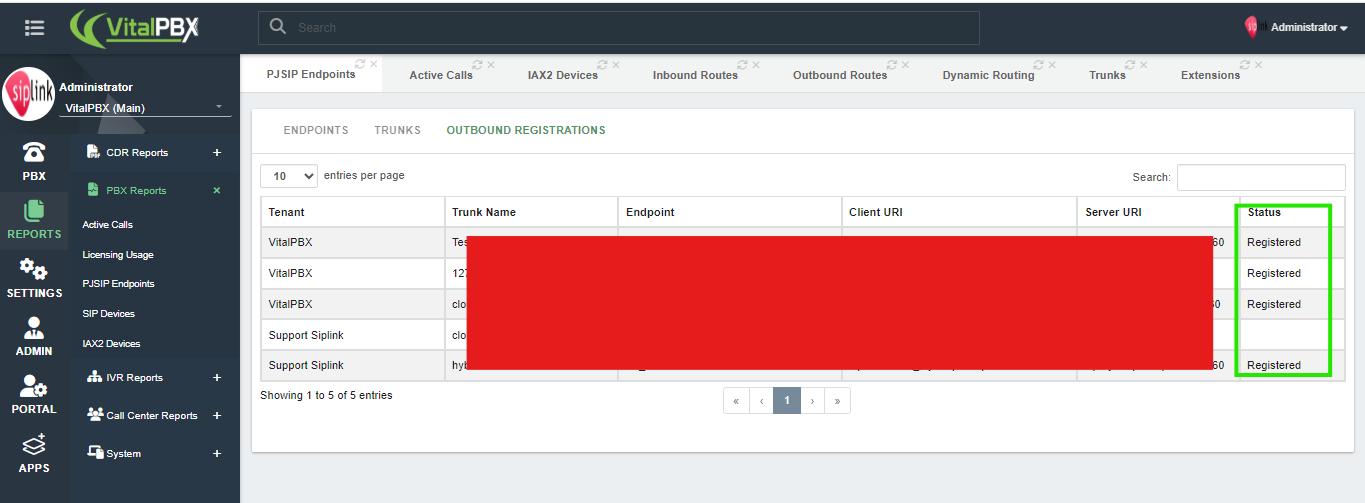

Here are my logs and that account as a DID, and if I register that trunk account in a softphone, the calls get through, and if I use the account in a different PBX, that also works and I get incoming calls, but I don’t know why it’s not working here.
