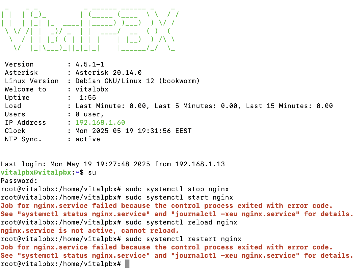

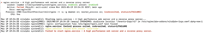

Hello everyone,
I recently upgraded the system to version 4.5.1-1. After the update, I lost access to the admin interface. However, the system itself appears to be running fine, and I am still able to connect via SSH.

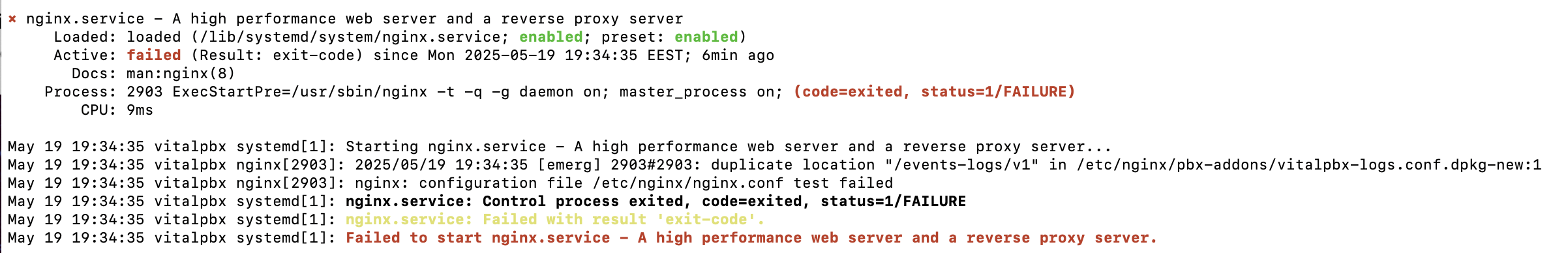

I’ve attached some screenshots that might help. It seems there is an issue related to Nginx.
Any assistance would be greatly appreciated.
sudo systemctl status nginx
Execute the commands below and restart NGINX
apt clean all
apt update
apt upgrade -y
Then,
/usr/share/vitalpbx/scripts/config_web_server
Finally,
systemctl restart nginx

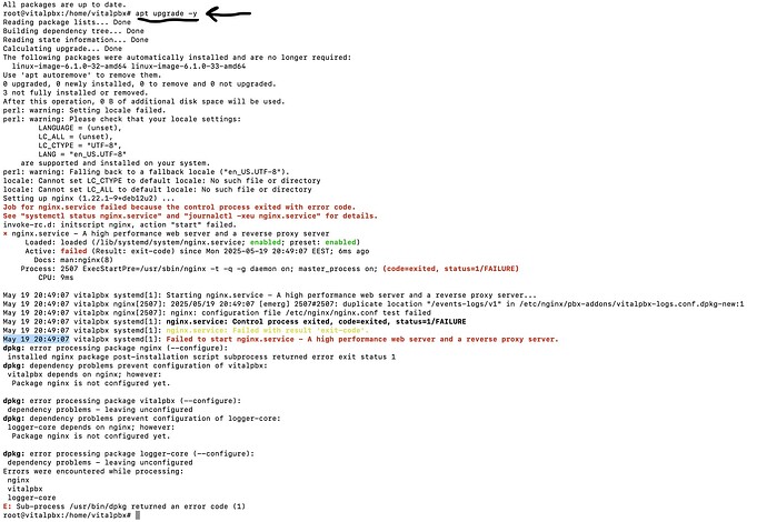

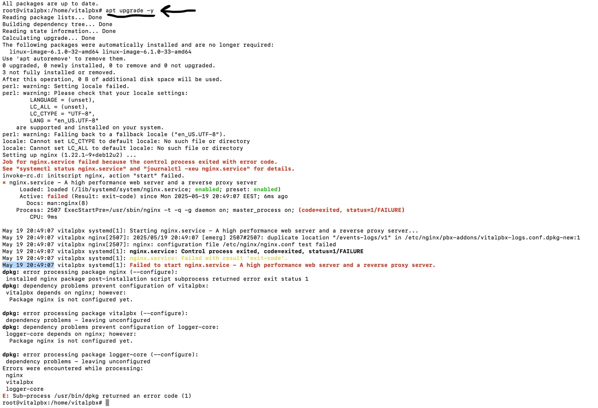

Dear Miguel,
Thank you very much for your prompt response and support. I’d like to inform you that I am now able to access the control panel successfully.
Note:
I have attached the output of the commands you provided. It appears that there are some issues indicated in the results—could you please confirm whether these might affect the system’s performance?
Output of #apt upgrade -y**
Thanks again for your valuable assistance.

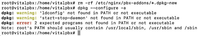

Do the following:
rm -rf /etc/nginx/pbx-addons/*.dpkg-new

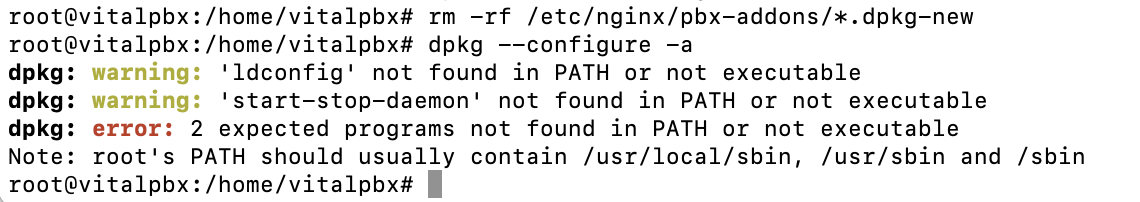

Thne,
dpkg --configure -a
Output : #dpkg --configure -a

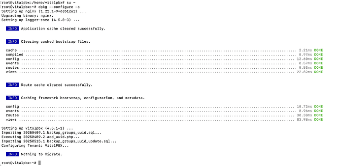

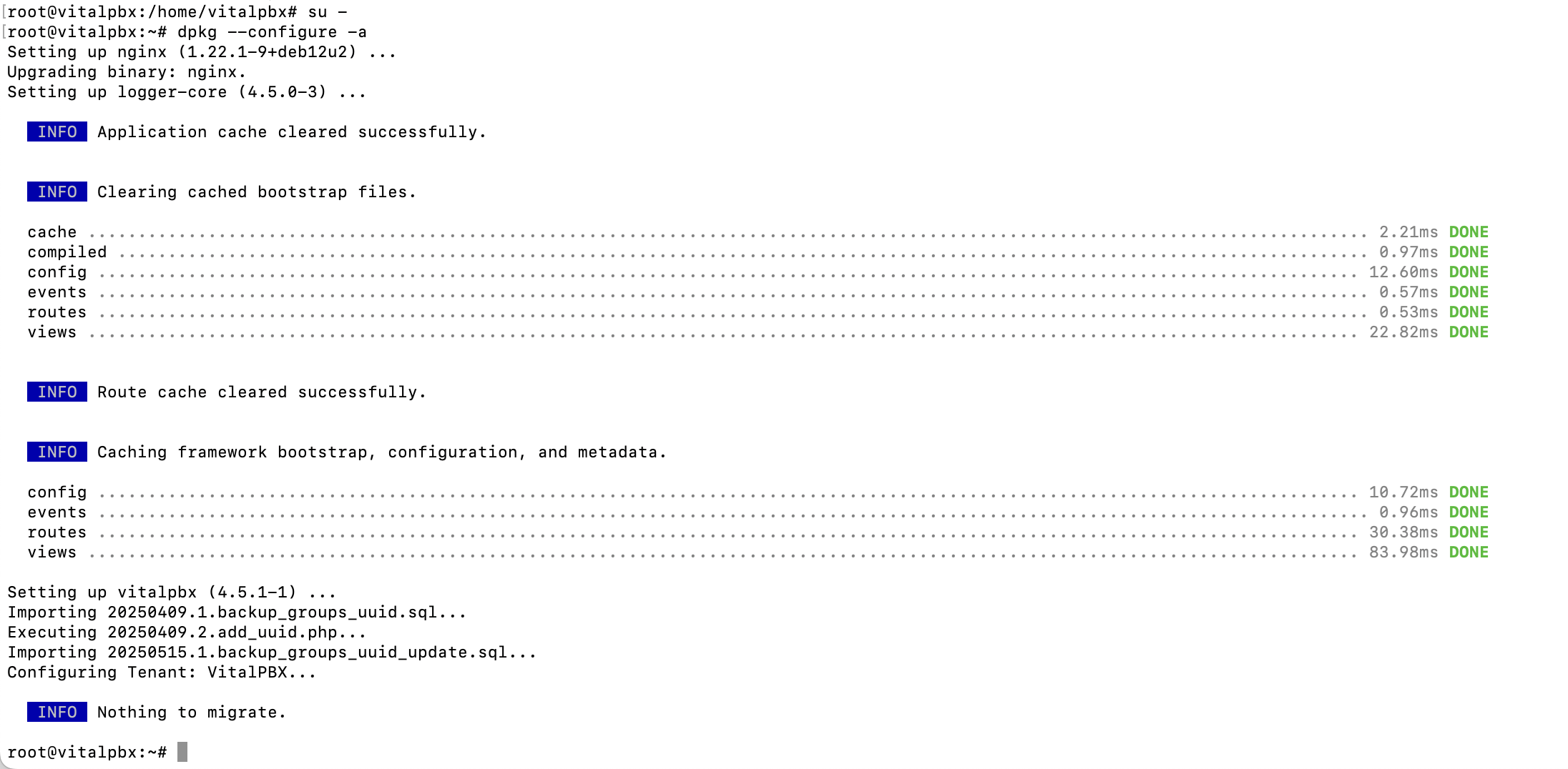

Try running the command below. maybe you are not running the CLI with full root privileges!
su -
Dear Miguel,
I believe the issue has been resolved. Please find attached a screenshot of the output for your reference.

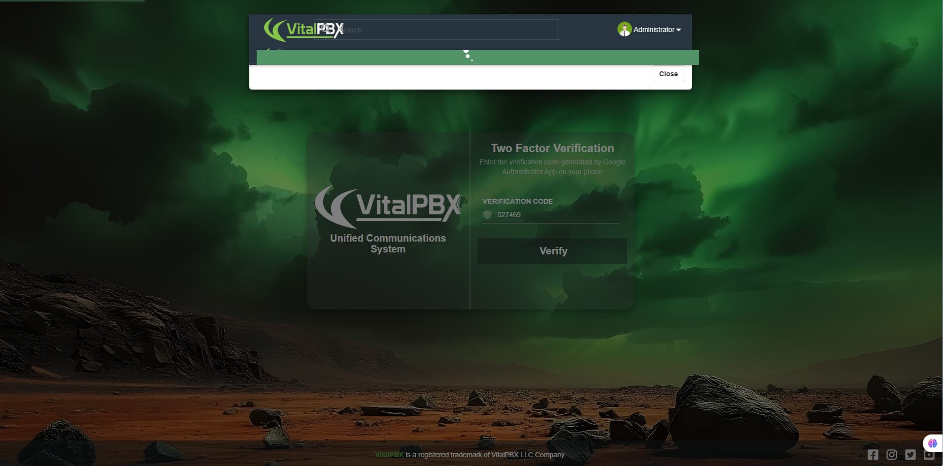

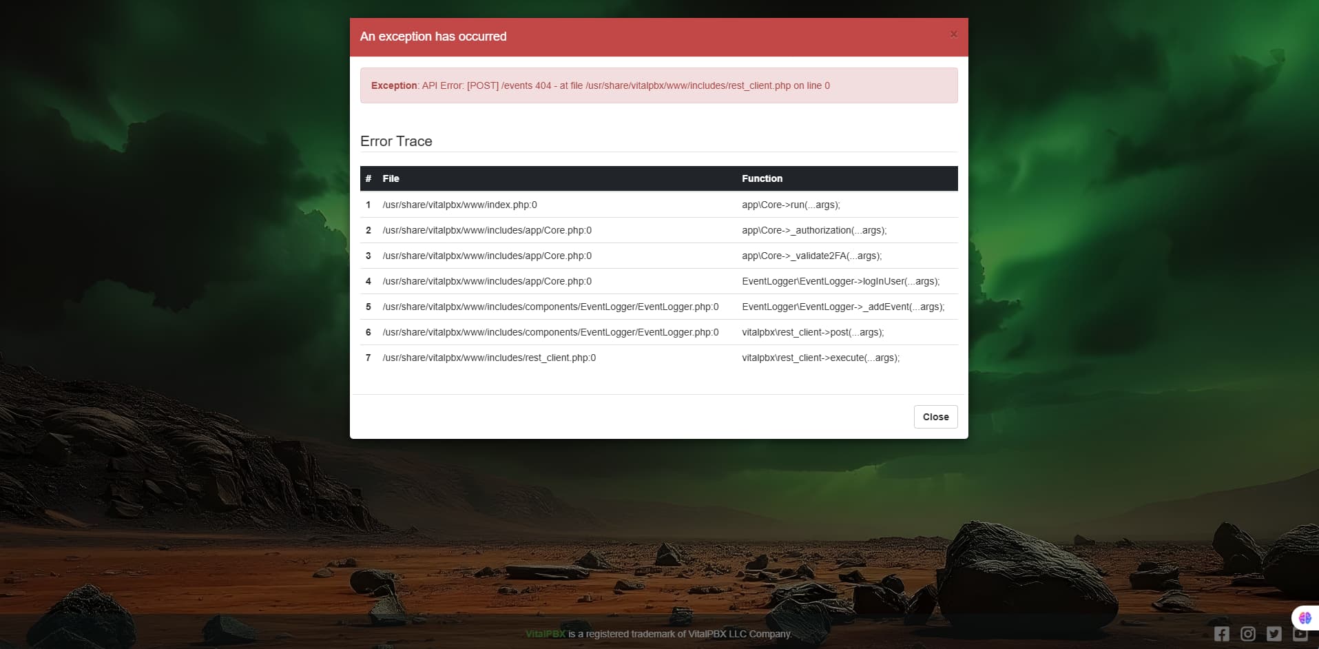

Dear Miguel,
Following up on the previous issue that has not been fully resolved, although I am now able to access the control panel after multiple attempts, I have attached screenshots to illustrate the problem.
Despite the attached issues, I am still able to access the control panel in the end, but the problem remains somewhat annoying.

Dear Miguel,
Thank you for your attention to the mentioned issue. I have executed the commands you provided; however, the problem still appears when accessing the system control panel for the first time. Interestingly, the issue disappears after refreshing the page.
Kind regards,
Try a private tab and a different browser.
Clean browser cache.
Did you restart NGINX as I noted I had to?
