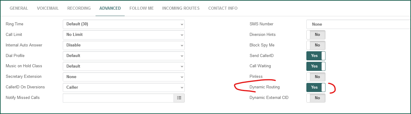

I activated the Dynamic Routing from extention settings and tried to test and the called cid not storing in dynamic routing list
any Advice ?
Did you select the Dynamic Routing option in the ADVANCED Tab extension?

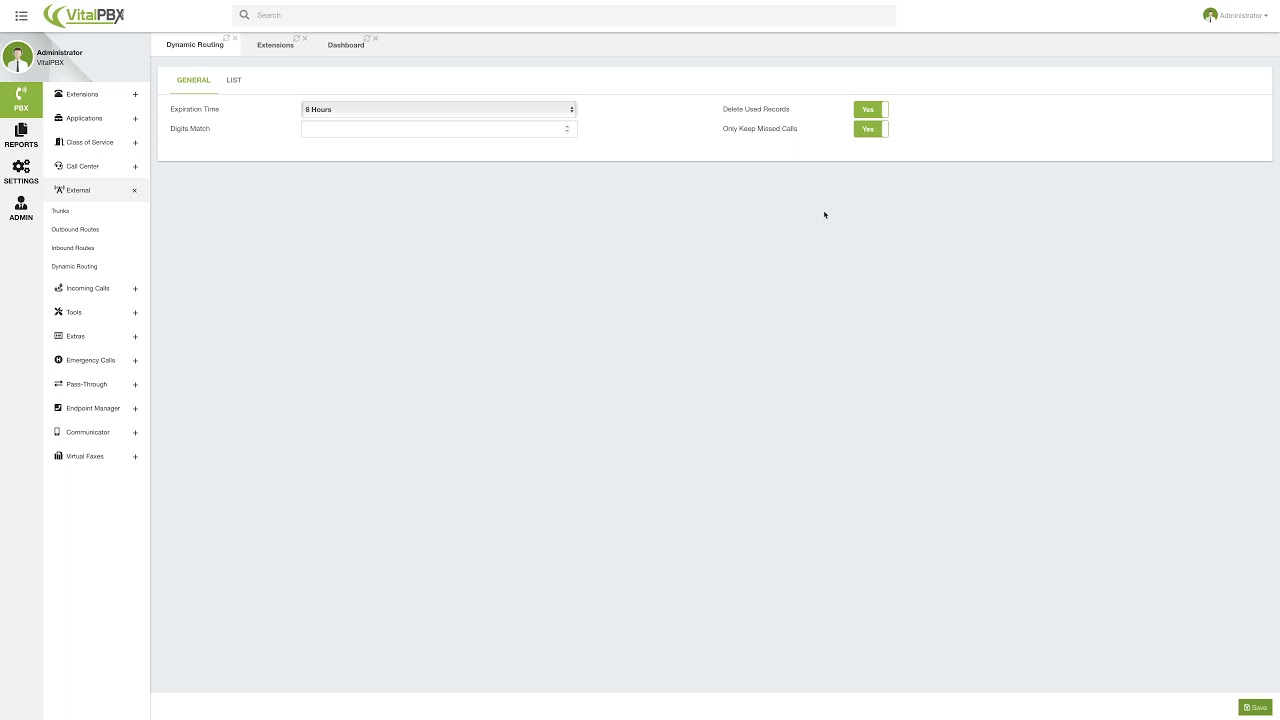

It also removes the “Only Keep Missed Calls” option in the Dynamic Routing module.

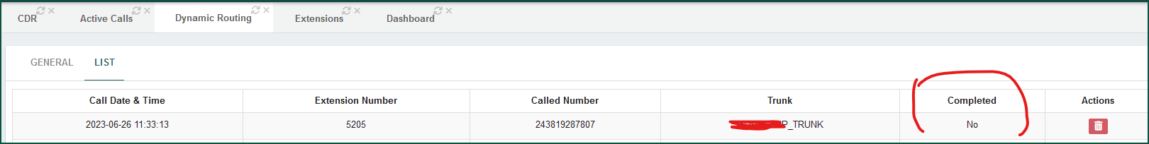

After activating Dynamic Routing on an extension and did an outbound call, i can see that the last call is listed in Dynamic Routing List BUT when the phone that received call called back to the same DID number, it listens to the IVR message instead of directly connects to the extension that called him.
On the Screenshot bellow, we can see that extension made outgoing call, the handset took the call, but here it shows "Call Completed: No).

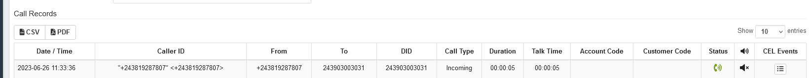

Then when the receiver calls back the DID number, call is not redirected directly to the extension that originated call, it’s going to the IVR as seen on bellow ScreenShot

It worked for me; The issue was the format of the Calee number.
In Outgoing call the number doesnt have + prefixed but in incoming call it was coming with +, i think due to this, system was considering they are 2 different numbers
