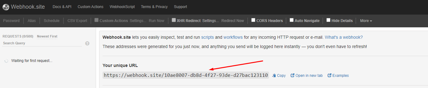

Go to the link below and use the unique URL as the Webhook URL on VoxTelesys.
Then share here what VoXTelesys is sending in the incoming messages. You will see on the app above the VoXTelesys Webhook like in the image below.
Hide any sensible data if needed.
