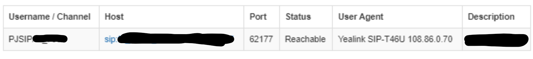

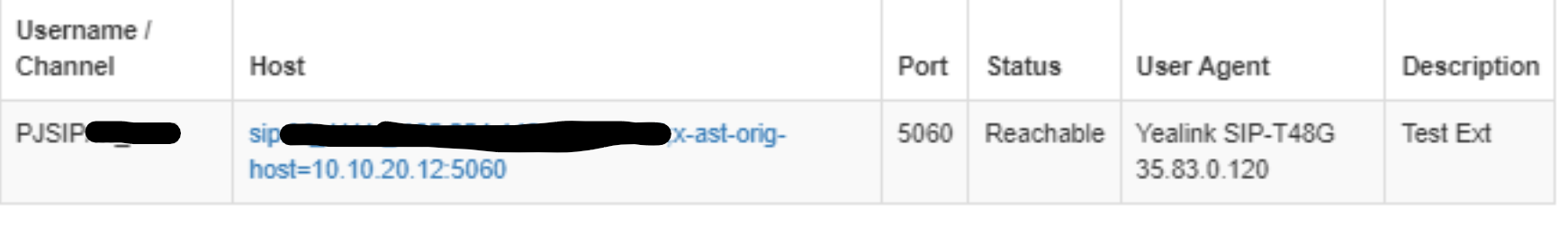

We have noticed that since the last update the extension status no longer shows the internal IP which was really handy for when supporting end users remotely.
Here is how it used to look:
but here is how it is now:
I have tried rebooting the phones but still no joy. Was this part of the update or is there and easy fix?

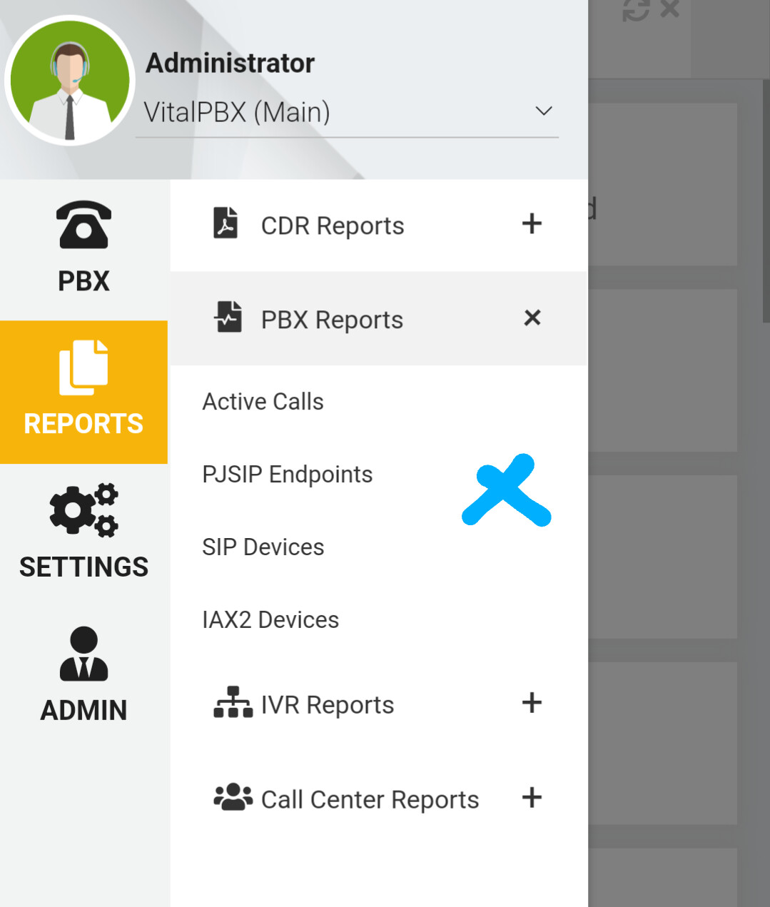

Hi, have a look at pjsip endpoints.
It should show you IPs.
Does this help you?

No unfortunately its only showing me the external IP and not the internal one.
It was really handy as you could click the hyperlink and it too you straight to the IP of the phone.

That information is automatically generated by Asterisk. VitalPBX just shows the information that Asterisk provides.
Anyway, depending on the environment, it’s normal that you cannot see the internal IP of the phone sometimes.
Here’s more information about the x-ast-orig-host header.
x-ast-orig-host is a header we add to incoming requests when rewrite_contact is on AND the host we get the request from is different from the host in the contact URI. We do this so we can restore the original contact URI when we send responses. Here’s the scenario…
A client behind a firewall sends Asterisk a REGISTER request. The contact URI is probably going to be a non-routable ip address like 192.168.0.1 but the host the packet comes from will be the public ip address of the firewall. In order to properly route responses and subsequent requests, the “rewrite_contact” option can be used to force Asterisk to substitute the private ip address in the contact header with the public ip address we actually got the packet from. This way we send responses and new requests to the public ip address. This all works well except for 1 scenario… When a client sends a REGISTER request, they can use the IP address in the contact header of the response to match it to the request. If we’ve rewritten the contact header, they won’t be able to match it. So we save off the contact host into that x-ast-orig-host header and when we send responses back to the client, we still send it to the public ip address git we reset the contact host back to what was in the original request. We then strip all x-ast* headers before we actually send the packets.

It just seems that we are now missing the x-ast-orig-host= header but it used to be there :frowning:
