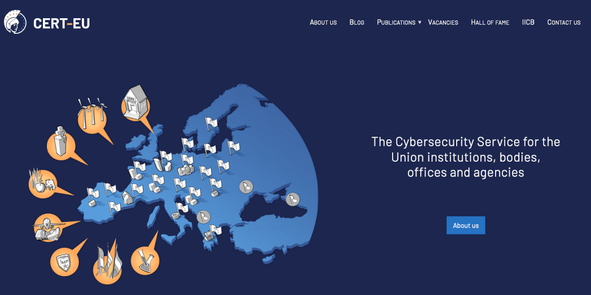

For additional information about these vulnerabilities, please refer to the CERT-EU security advisory:
