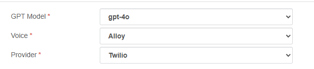

I don’t understand why we need a provider here and it looks like the only option is Twilio but there’s no place to put API keys or anything for that. I’d expect this to just work with OpenAI keys only and am not understanding Twilio’s roll.

Thanks for the video miguel. I’m not understanding why Twilio is required for this. Why not stream the call directly between VitalPBX and OpenAI using the realtime model?
Streaming calls from Asterisk to OpenAI is quite challenging. We are utilizing the integration that Twilio provides, which simplifies the process of streaming the call and connecting with OpenAI.
