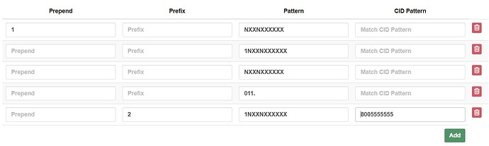

So if i want 2 to use the CID 8005555555 the it should look like this?

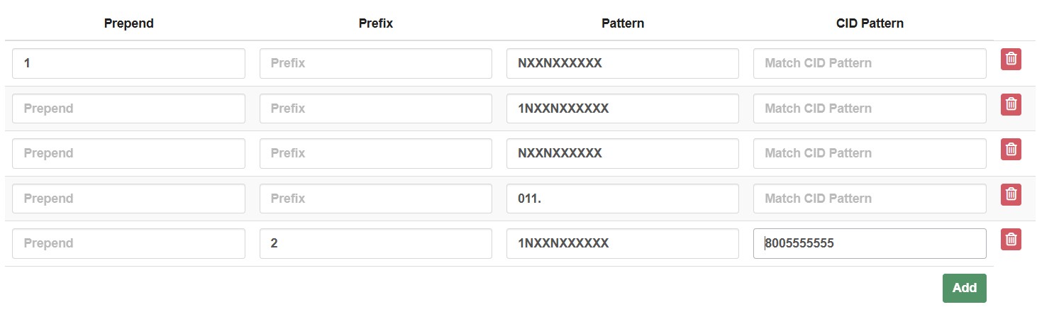

@miguel Does the screenshot look right? Or did I mess that one up haha.
The issue was the pattern was incorrect. I put a * in it and that was causing it to fail.
