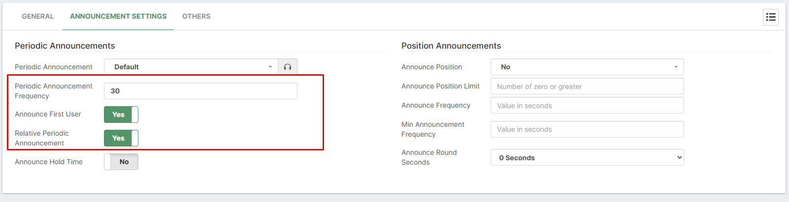

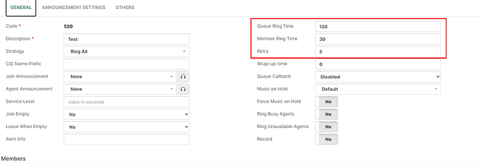

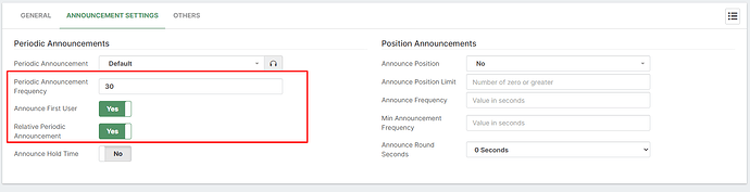

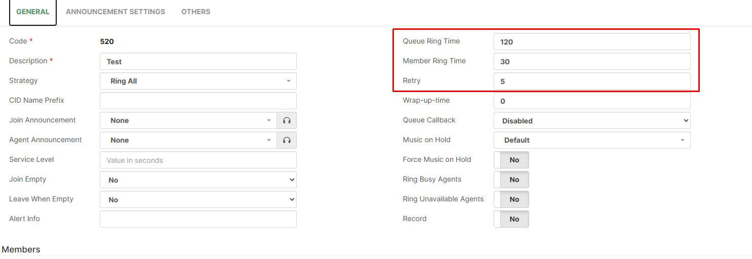

To configure your Periodic Announcement correctly, you must consider the queue’s agent ringing time and retry interval.
For example, if the Members Ring Time is set to 30 seconds and the Retry Time is set to 5 seconds, the queue cycle is approximately 35 seconds.
In this case, we recommend configuring the Periodic Announcement Frequency to 35 seconds or higher, such as 35, 70, or 105 seconds.
If the announcement becomes due while the queue members are still ringing, Asterisk may delay it until the current ringing attempt finishes.
Also, if you want the periodic announcement to play when there is only one caller waiting in the queue, make sure Announce to First User is enabled.
