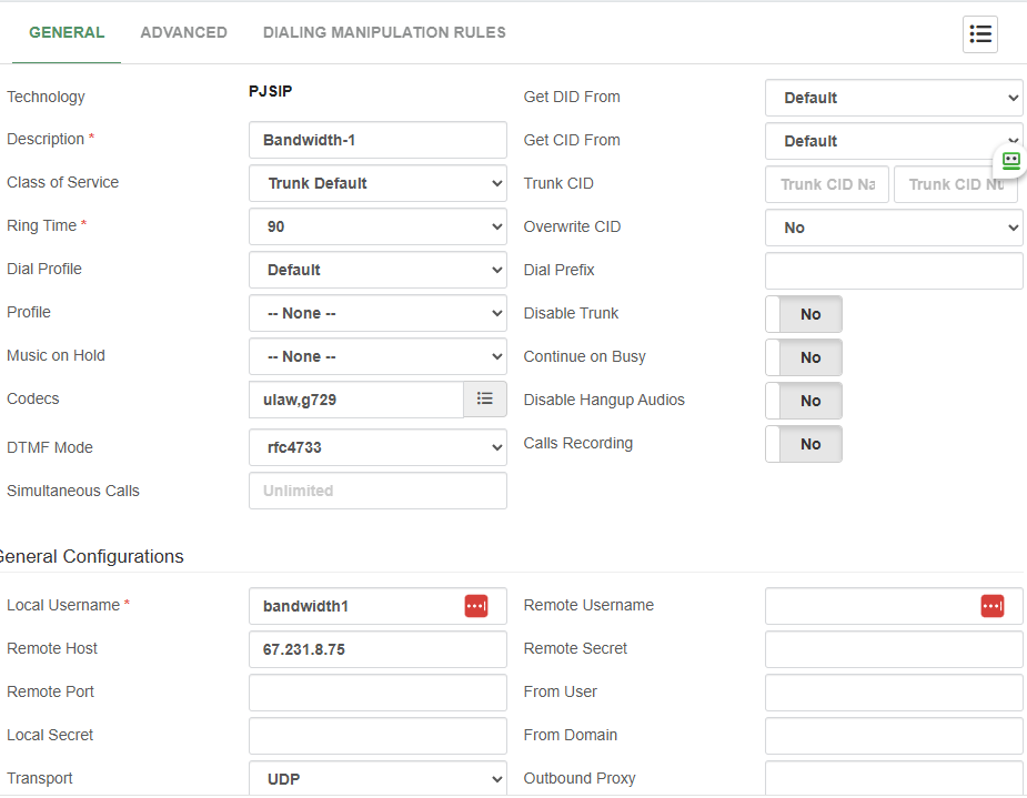

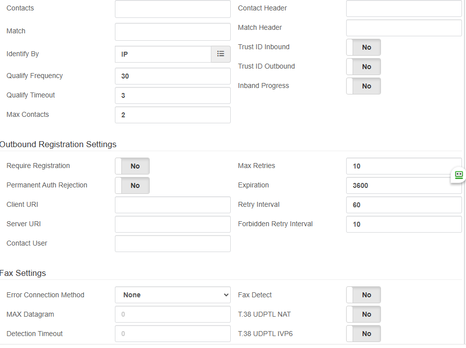

I have a friend that I am helping to move over to VitalPBX. He uses Bandwidth as a carrier and they use IP Auth Trunks. Could someone take a look at our trunk settings and see if this looks right or do we need to change anything?

Define the “Match” field using the Bandwidth trunk IP or Domain. You can define multiple IP/Domains, or IP Ranges (e.g., 10.0.0.1/24)
Select the “Default PJSIP Profile” or another desired “PJSIP” profile in the “Profile” field.
Thank You Miguel! That worked.
