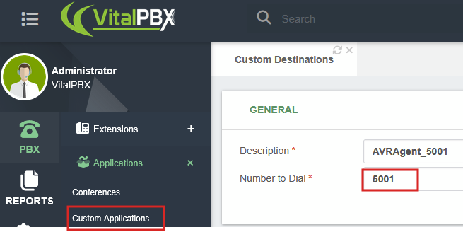

And last in VitalPBX I added custom destinations for the new extensions
To test I created custom destinations for 5001, 5002, and 5003. Setup an IVR with 1 routed to 5001, 2 to 5002, and 3 to 5003.
Calling in to the system you should now be able to select an extension and the talk to OpenAI Realtime. Note with this basic prompt OpenAI was not responding until I said something.
