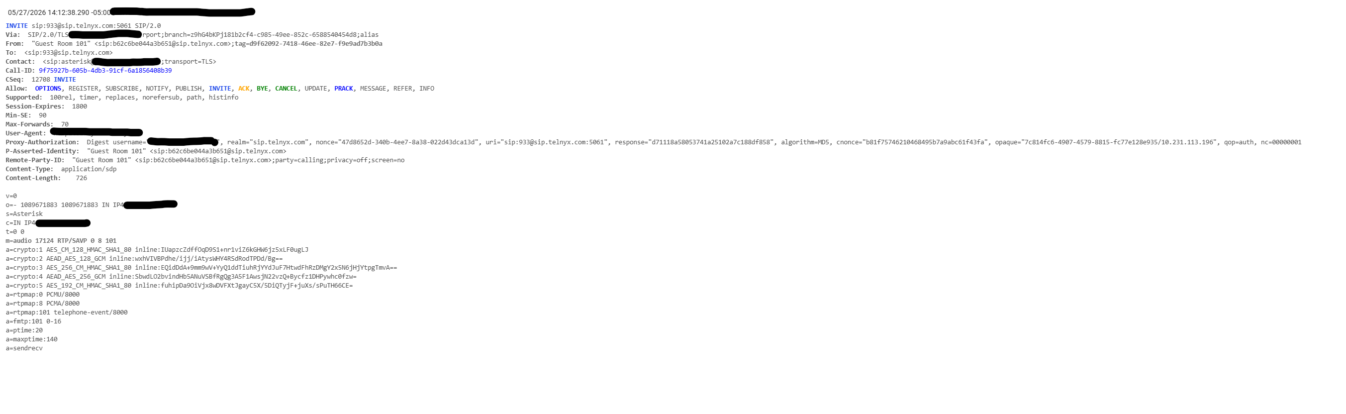

Per the Telnyx docs, Dynamic E911 expects both P-Asserted-Identity (with sip_from_id) AND a Geolocation header in the INVITE. The current VitalPBX INVITE has P-Asserted-Identity and From, but no Geolocation.

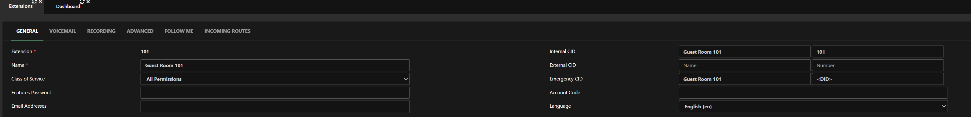

I’ll create a Dynamic Emergency Address/Endpoint in Telnyx, put the sip_from_id in the Emergency CID Number field, dial 933, If it works with just sip_from_id, great. If not, the feature request stands — adding a Geolocation field next to Emergency CID Name/Number would make VitalPBX fully compatible with Telnyx Dynamic E911.

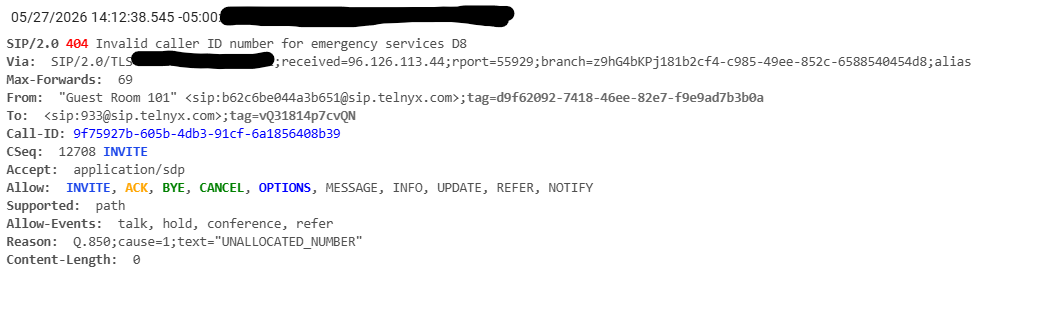

Yes correct I generated the address on the Telnyx side tried with only sip_from_id and it didn’t work in telnyx, It gave rejection.
I did check with Telnyx support is dose need both generated values in invite packet: sip_from_id or P-Asserted-Identity and Geolocation

I cannot set Geolocation in the trunk as this is a multitenant PBX plus for each extension will have their own sip_from_id and sip_geolocation_id generated on telnyx side. So need a way to set the Geolocation similar to what is already there for sip_from_id and P-Asserted-Identity.
Just need to add a option to statically set the Geolocation value in Emergency CID next to name and number and needs to be sent in invite when emergency number is dialed.
