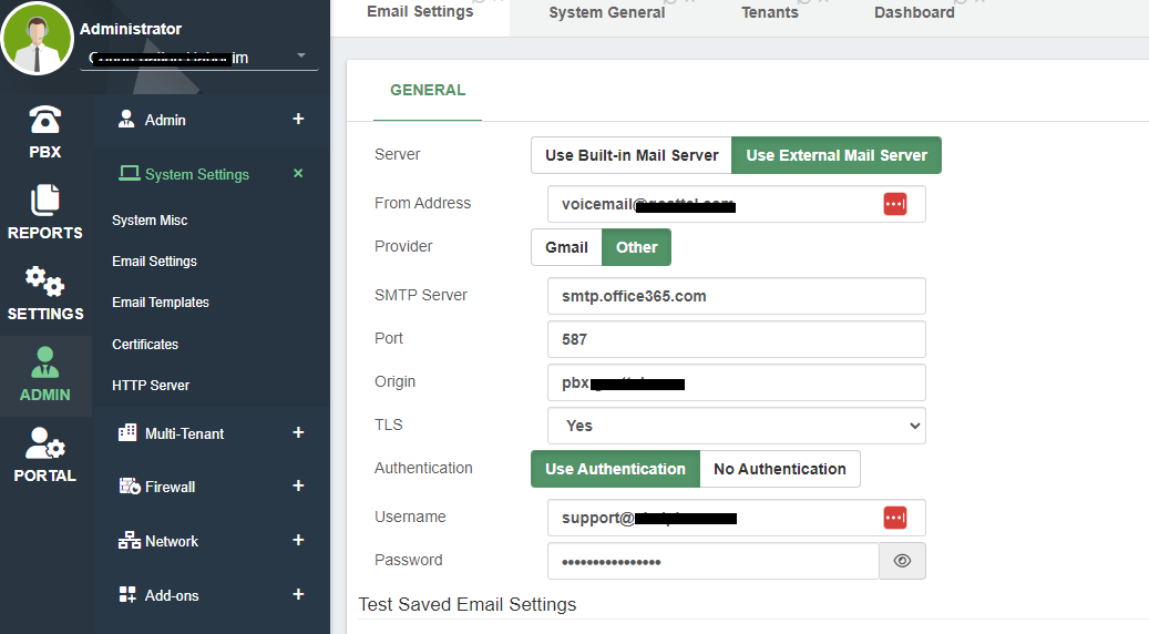

When i go to the email settings in the tenant, it has the same info as the main tenant. Is there another email setting I am missing?
Here is the SMTP settings in the sub tenant
  1. The e-mail settings are global. So, you should avoid sharing global modules with sub-tenants.
  2. For the Welcome e-mail option, you must define an e-mail address(es) per extension.
