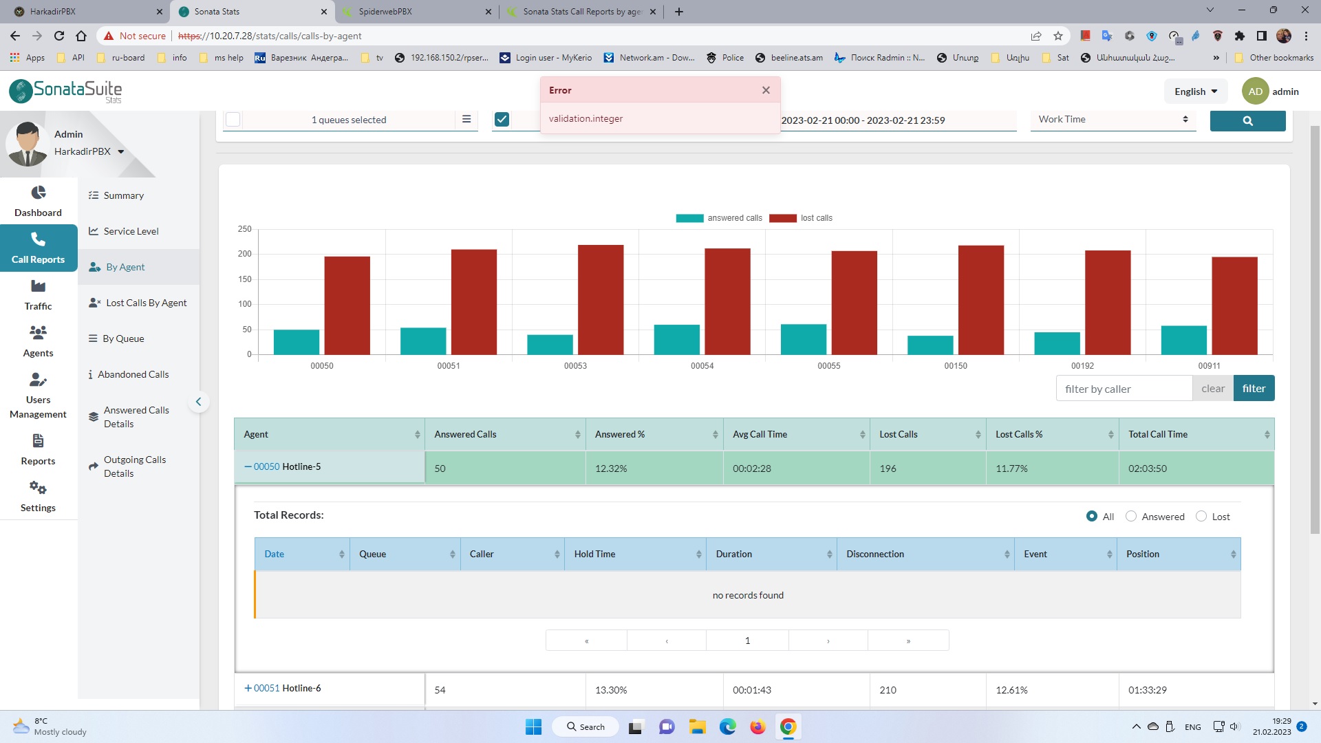

Sonata Stats Call Reports by agent Error
When I try Sonata Stats Call Reports by agent and click on + to see Records for agent I receive Error validation.integer
When I want to see Call Reports by agent and click on + for records, I receive Error “validation.integer”
Could you please send us a screenshot of this issue?

I do it by your instruction, but error is present
There was no such directory in location /usr/share/
sonata does not exist
Location is /usr/share/queues-stats/backend/app/Http/Requests
It’s work, thank you
